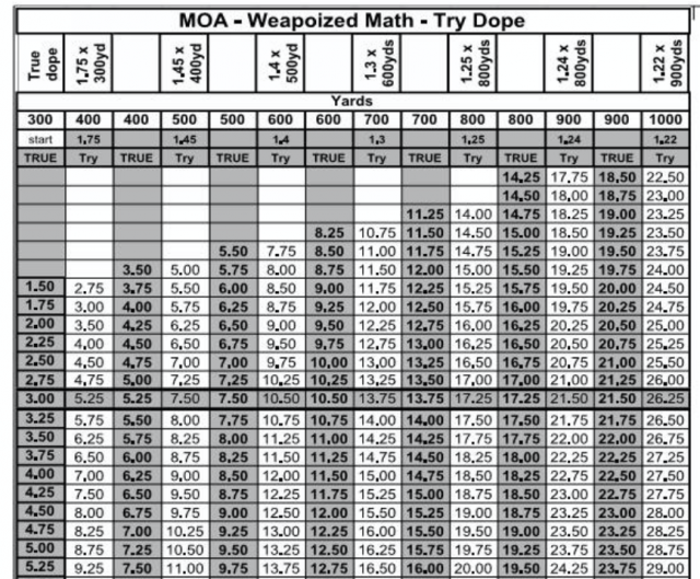

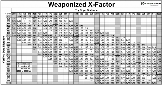

Problem Number Five: Weaponized Math
Going Inside the Numbers / Balistique - TLD X-Factor-Data-640x335
Not a problem at all, really.  It’s an easy-to-use data page where you progress down range by using the next multiplier for the last yard line’s center-of-plate data. Simply MULTIPLY your 300 yard data by 1.75 and you will be on or near the center of the plate at 400 yards.  FINE TUNE it and move on to the next yard line and the next multiplier.
300 Yard Data X 1.75 = 400 Yard Data
400 Yard Data X 1.45 = 500 Yard Data
500 Yard Data X 1.40 = 600 Yard Data
600 Yard Data X 1.30 = 700 Yard Data
700 Yard Data X 1.25 = 800 Yard Data
800 Yard Data X 1.24 = 900 Yard Data
900 Yard Data X 1.22 = 1000 Yard Data
We have posted Worksheets for Weaponized Math and there are published Flow Charts that will accomplish the same.  Thanks, @JackMaster.  The important part is to WRITE IT DOWN when you have what you believe to be correct data at each yard line.
